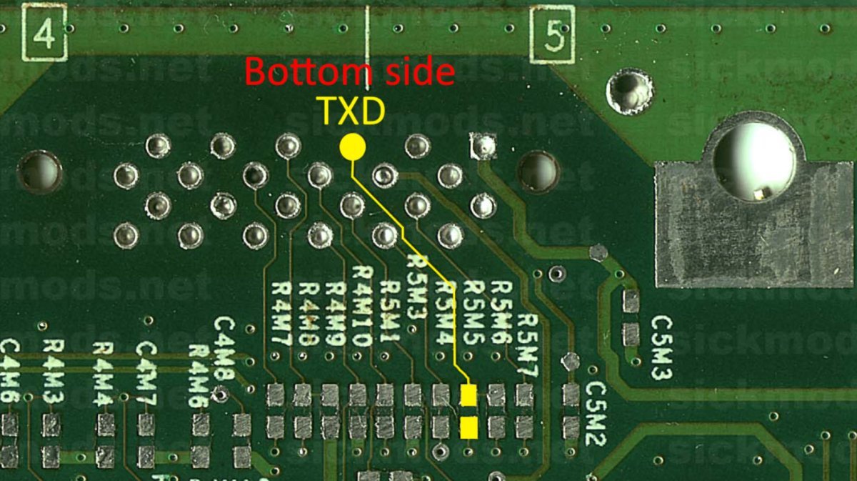

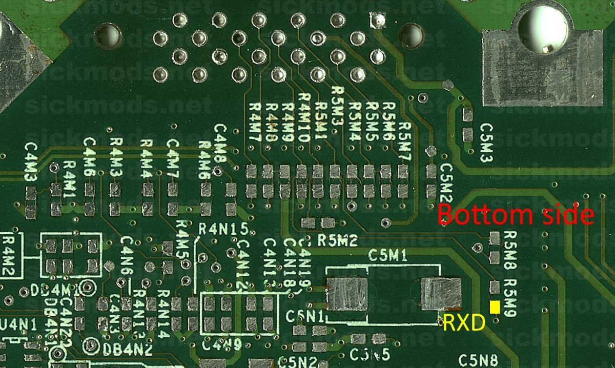

Xbox-Scene Posted May 5 Posted May 5 Hi Everyone While reviewing the schematics, we did notice something interesting , the resistors R4M10 and R5M3 are not populated on debug Xbox units, but they are present on retail boards. You can tell by the asterisk next to each resistor value, which typically indicates a “Do Not Populate” (DNP) part in production for certain versions (in this case, debug / test units). From what we can tell, these resistors are used to disable the debug UART pins on retail units. They don’t appear to be related to AV pack detection or AV mode selection but some people have reported fragging using composite cable after removing the resistors. Just to be safe, I chose to hardwire the UART connections directly to the motherboard. I then routed those wires out through the front of the case. On the external end, I terminated the wires with a male pin header, and my programmer connects using a female header plug. This discovery is still new, and we’re learning a lot as we go. With ongoing feedback and testing from the community, I’m sure we’ll uncover alternative methods and figure out what works best and what doesn’t. Quote

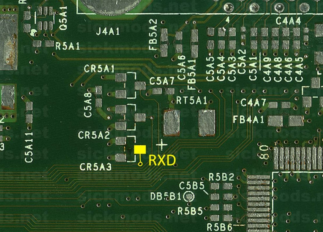

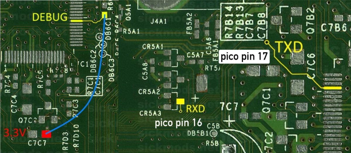

b3ncs1 Posted May 5 Posted May 5 for those want to use a pico, i wrote down the whole process that worked for me - i used this exact fw: https://github.com/JoeSc/pico-sexa-uart-bridge - i soldered in the connections on the picture with 40awg wire - the pico emulates 6 com ports, and i used the 4. one, you have to test it which works for you - verified with a stock bios dump from an 1.6 to ensure the communication between the pc and the console is flawless. (note: i couldn't dump the bios succesfully with the dumper script.) - when the stock bios verification ended succesfully i flashed the cerbios.bin note 2: you can make soldering the txd via easier if you scratch it a little with an exacto knife note 3: i used the lpc port ground point 1 Quote

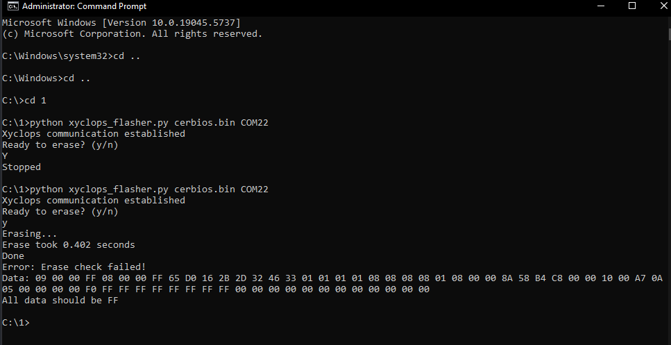

VIP Members Prehistoricman Posted May 6 Author VIP Members Posted May 6 (edited) 2 hours ago, Prabhu said: I tried with my 1.6 which has A-B01 and i got this error. C:\Users\Prabhu>python C:\Users\Prabhu\Desktop\xyclops_flasher.py C:\Users\Prabhu\Desktop\bios.bin COM4 Sync failed... trying 38400 baud Error: No communication from Xyclops. Check connections or try unplugging your Xbox for 10 seconds. So, curious for the update. B01 still has communication OK so you have a problem with your setup. I expect B01 to produce an erase check fail message like ModderFokker's above. Edited May 6 by Prehistoricman 1 Quote

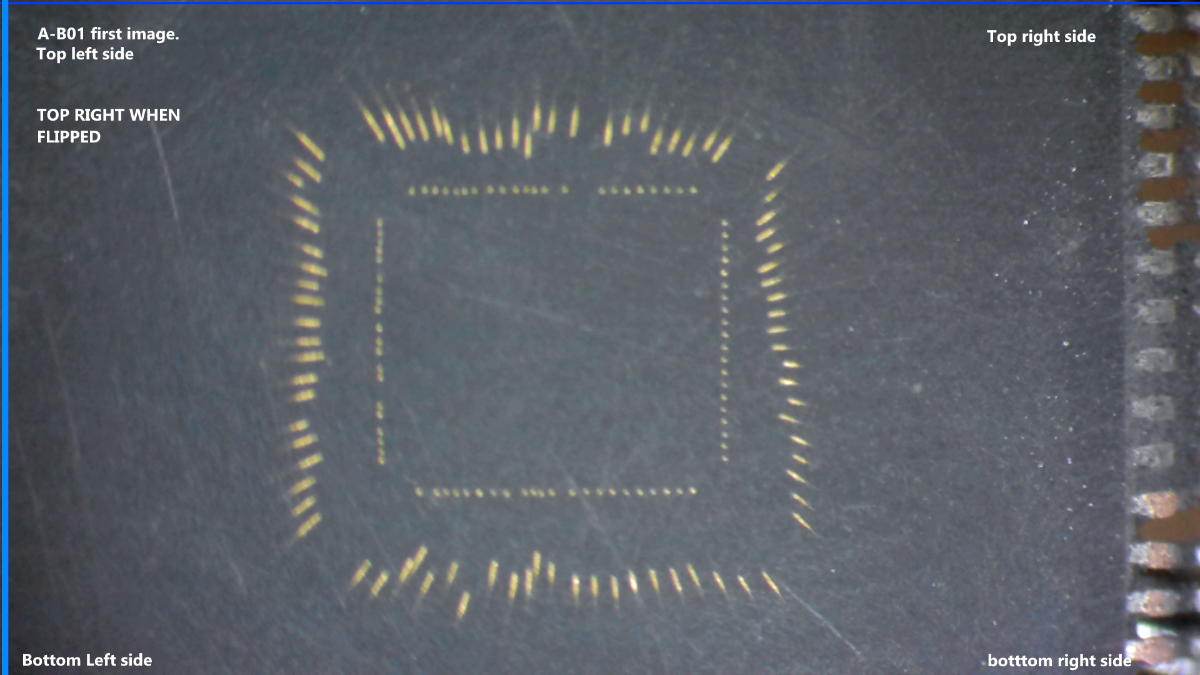

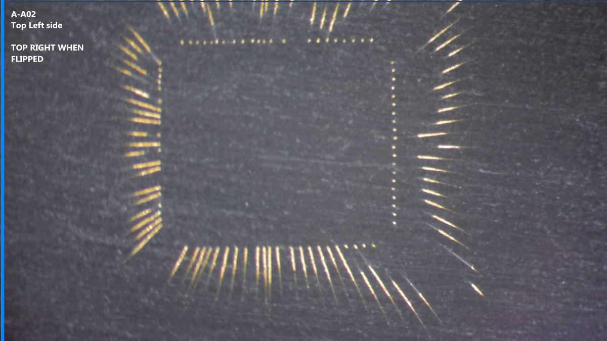

HoRnEyDvL Posted May 7 Posted May 7 We were fortunate enough to have 1 of our good friend sacrifice 2 Xyclops chips, A-A02 & A-B01. From a Die / Bond wire perspective they look identical however would need X-ray / De-cap to look deeper. What would also be good to document is the values / readings of each pin and compare the to revisions. If anyone wants to do that & share information would be great. 1 Quote
VIP Members Prehistoricman Posted May 7 Author VIP Members Posted May 7 Can our friend do a precise size measurement? I expected the B01 die to be smaller. Quote
