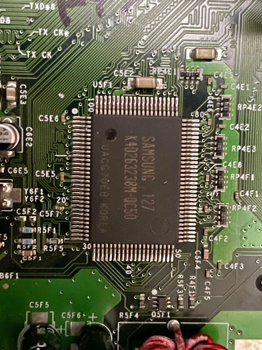

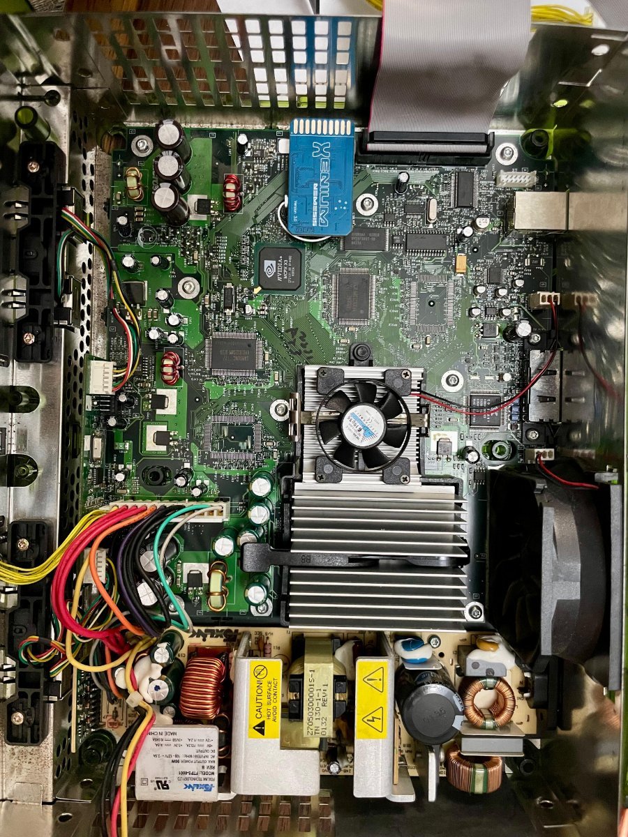

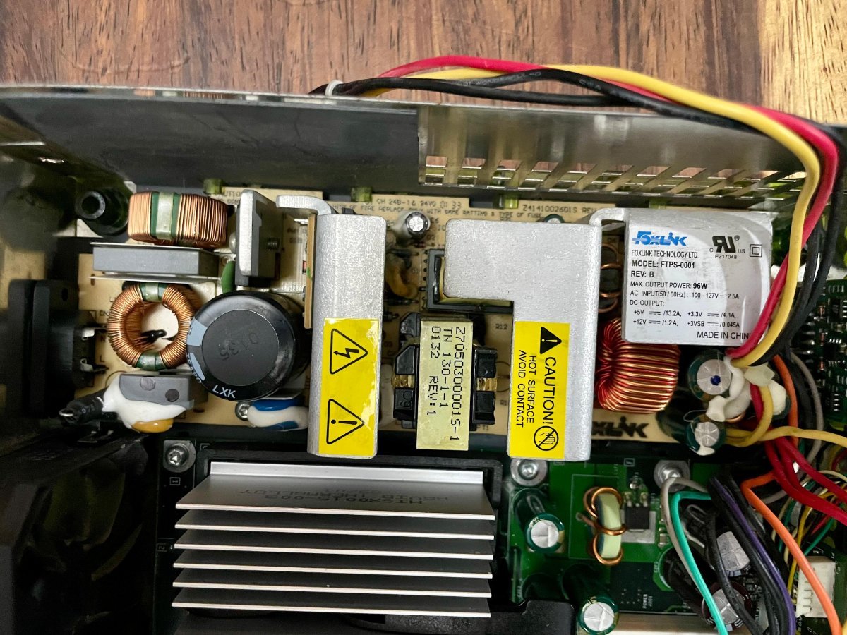

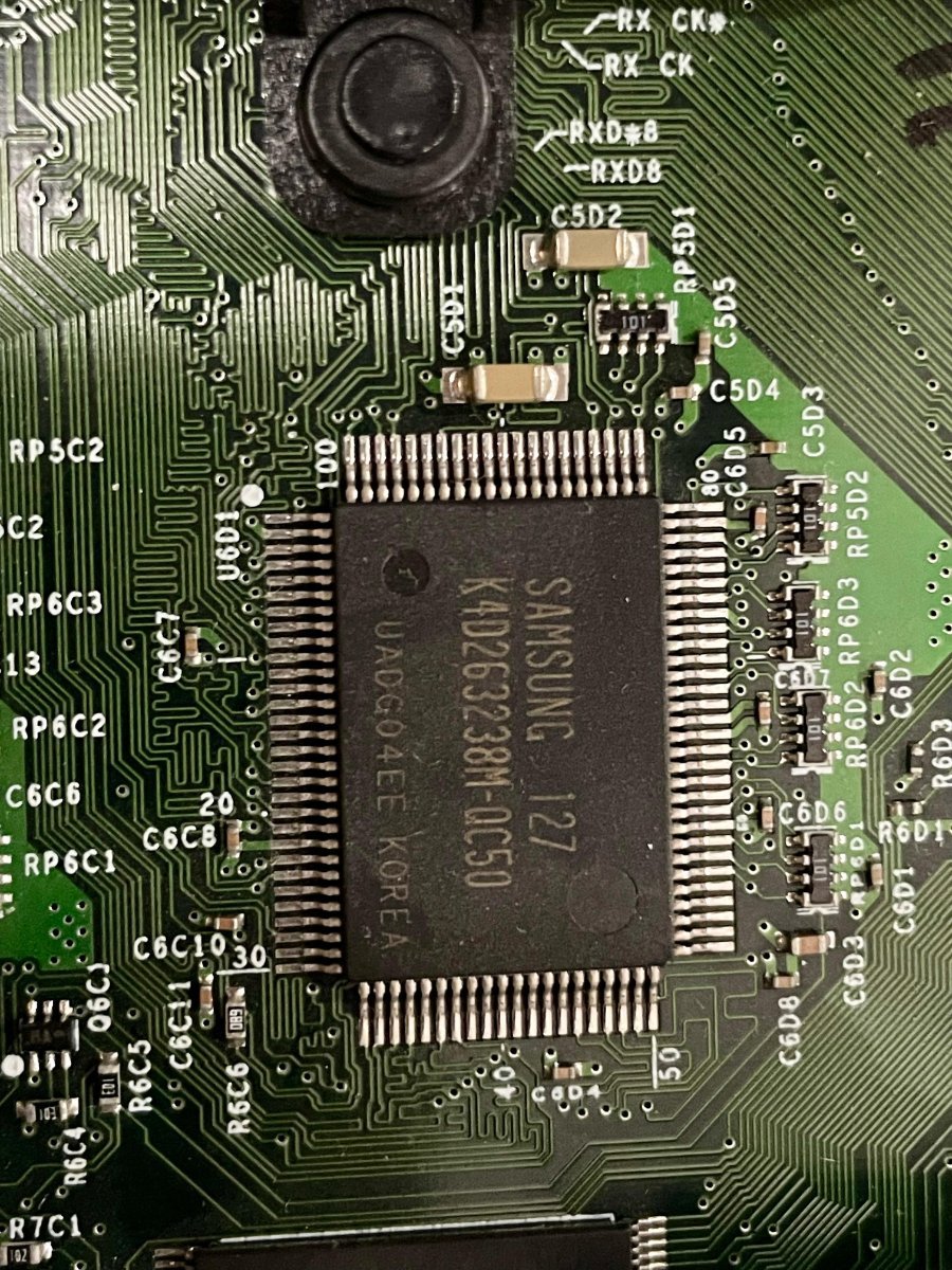

gregandcin Posted November 5, 2023 Share Posted November 5, 2023 (edited) This OP, for all intents and purposes, is to throw all the discussions of the issues reported by members of the Discord community into an easier to get to place. There seems to be an issue with NTSC 1.0 consoles when trying to play games or video content using Cerbios versions newer than 2.0.3r. Bellow are posts and pictures from the Discord discussions: Quote gregandcin — 02/21/2023 7:46 PM Got around to testing 2.1.0 and 2.2.0, they both crash same as 2.2.1. Did a sanity check on 2.0.3R and that still works So 2.1.0 introduced some sort of regression Also, just added the boot animations and those crash 2.1.0, 2.2.0, and 2.2.1 on all UDMA versions So to recap for the Cerbios team who may or may not be watching: Cerbios 2.1.0 and onward has introduced a regression in 1.0 NTSC consoles that was not present in 2.0.3R. This causes many, if not all, games to crash (in my case a full system freeze needing a system restart) regardless of game type (loose, XISO, CCI). This can be reproduced in some instances, and across all UDMA versions (edited) [7:51 PM] This happens even in the best case scenario of SSD, 80 pin wire, and StarTek adapter DVD Drive - Phillips Quote xprotestthegyro — 09/21/2023 12:27 AM Fatal Frame 2 freezes regularly when loading assets for new areas (transitioning between rooms / opening doors). No issues on Cerbios 2.0.3R MoBo: v1.0 (fully recapped mobo + PSU) RAM: 128mb (verified in xblast) Modchip: Jafar (Aladdin XBLAST) HDD: Samsung 870 QVO 2TB SSD - Startech SATA/IDE Adaptor w/ 80wire IDE Cable Bios: Cerbios 2.3.0/2.3.1 Standard/UDMA Quote Eliud — 02/19/2023 7:05 PM My setup is as follows: Xbox 1.0 Aladdin XT Plus Generic 18" Ultra ATA 66/100/133 IDE 40 Pin (80 Wire) Generic SATA to IDE adapter when using a 250GB Seagate SATA drive, otherwise using a 400GB Hitachi IDE drive Quote dj0wns — 09/21/2023 12:30 AM Mobo: 1.0 Tsop flashed Ram: 64 mb Hdd: aftermarket 80 gb ide or Samsung 870 SSD on startech IDE: stock 40 pin, ebay 80pin, Xbox specific 80 pin DVD Drive - None An Imgur Gallery of all of the Xbox's posted by their users: https://imgur.com/a/IpHShIS Games known to have issues: Fatal Frame 2 NTSC (Eluid, xprotestthegyro) Project Gotham Racing NTSC (dj0wns) Project Gotham Racing 2 NTSC (dj0wns) Double Steal NTSC (dj0wns) Halo 2 NTSC (gregandcin) More to come... Edited November 6, 2023 by gregandcin Update tested games Quote Link to comment Share on other sites More sharing options...
Dempsey_86 Posted November 5, 2023 Share Posted November 5, 2023 1 hour ago, gregandcin said: This OP, for all intents and purposes, is to throw all the discussions of the issues reported by members of the Discord community into an easier to get to place. There seems to be an issue with NTSC 1.0 consoles when trying to play games or video content using Cerbios versions newer than 2.0.3r. Bellow are posts and pictures from the Discord discussions: An Imgur Gallery of all of the Xbox's posted by their users: https://imgur.com/a/IpHShIS Games known to have issues: Fatal Frame 2 NTSC (Eluid, xprotestthegyro, dj0wns) More to come... Can you also add the brand of the dvd drives used in the consoles? In case its a problem with the drives in combination with cerbios? The more info they have on the hardware combinations, the better. Quote Link to comment Share on other sites More sharing options...
