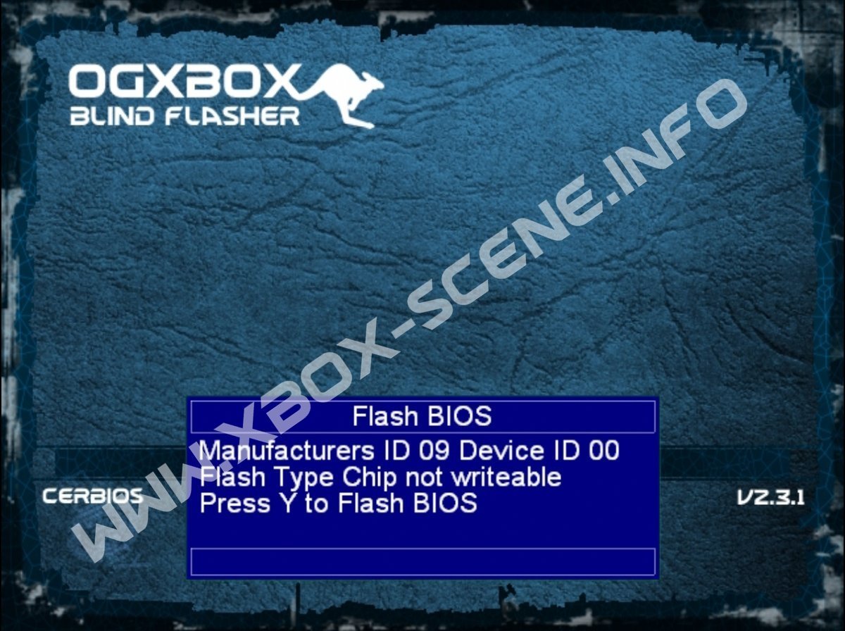

After the flasher has finished loading (Disc slows down) this screen will be on your TV (Which you ofc cant see).
There is no option to move up or down. There is just that one bios to flash! Cerbios 2.3.1 UDMA2.
And since you see nothing, just press the „A“ button on your controller.
PLEASE TAKE NOTE THAT YOU SEE HERE ON SCREEN 2 THAT THE FLASH
IS NOT WRITABLE. THIS IS BECAUSE I TAKE THE SCREENS IN XEMU!
 In your case there is the chip ID written as you may already now from previous flashes.
So let me pull the „TRUST ME BRO CARD“ and press the „Y“ button on your controller.
EvoX will now start to erase your old bios and after that Cerbios v2.3.1 will be flashed to your XBox. When EvoX has finish the flash, your XBox will shut down by it self!
After you have pressed the „Y“ button, give EvoX ~1-2 min. and do not touch anything.
